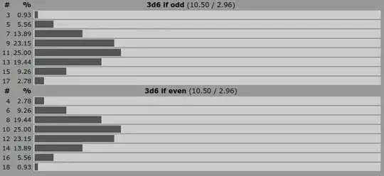

And we get a result that looks like this:
Anydice graph of 3d6 restricted to odd or even

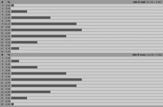

output [restrict 3d6 to {3,5,7,9,11,13,15,17}] named "3d6 if odd"
output [restrict 3d6 to {4,6,8,10,12,14,16,18}] named "3d6 if even"
and an example of the output:
Screenshot
(Surprisingly enough, it turns out that the average the same in both cases!)
