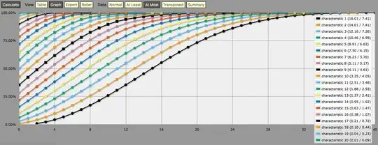

Here's a somewhat simpler solution, in two steps:
  1. First, make a custom d20 whose sides show the number of points needed to bring it under the target characteristic value:
    DIE: [highest of 0 and d20 - CHARACTERISTIC + 1]
  2. Then roll three of these dice, take the sum of the two lowest (i.e. the number of points needed to bring both of them under the target) and see if it's less than the number of skill points available:
    output [lowest 2 of 3dDIE] <= SKILL
Actually, we don't even need the <= SKILL part, if we just plot the cumulative probability of needing at most a given number of skill points to succeed. From this output, we can directly read that the success rate for characteristic 11 is 50% with skill 0, 57.13% with skill 1, 63.85% with skill 2, 70.11% with skill 3, etc.
If we wanted, we could even automatically run the same code for a range of characteristics and plot the results as a nice graph:
Plot of success rate vs. skill for various characteristics in Neuroshima, generated using AnyDice
This is what the entire code to generate the graph above looks like:
loop CHARACTERISTIC over {1..20} {
  output [lowest 2 of 3dDIE] named "characteristic [CHARACTERISTIC]"
Ps. One thing we can observe from the results is that one extra skill level is almost, but not quite as good as one extra point in the relevant characteristic. But two skill levels is still way better than one point in the characteristic.
That might seem a bit surprising, given that raising the characteristic effectively reduces all of your dice rolls by one, whereas an extra skill point only lets you reduce one of them. However, if one of your three dice is already less than your current characteristic, then there's no need to lower it any further, and in that case one extra skill level is indeed just as good as one extra point in the characteristic. And it turns out that this is a pretty common case — for example, the probability of rolling naturally under 11 (i.e. at most 10) on at least one out of 3d20 is 87.5%.
Also, it's worth noting that the values of the lowest and the middle roll on 3d20 are correlated: the larger the lowest roll is, the larger the middle roll must also be. Thus, at least for relatively low skill levels, the situations where an extra point in the characteristic would be more helpful than an extra skill point (i.e. where none of your natural rolls are under the characteristic) are usually also those where you've rolled so badly that neither will actually help.
For an illustrative example, this AnyDice script (using the empty die trick for calculating conditional probabilities) shows the skill level needed to succeed (with characteristic 11, although you can easily change that) when the lowest roll is either < 11 or ≥ 11. Notably, in the former case you have 57% chance of success even at skill 0, and a further 8% chance on top of that with skill 1, whereas in the latter case you need at least skill 2 to have any chance of success at all (since you need to lower both rolls by at least one)!
