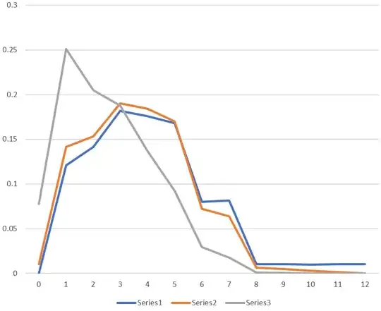

Don't use anydice for this
Once you get into certain types of rolls, especially ones where you might (theoretically) have infinite re-rolls and/or where what to do with a roll depends very on other rolls, Anydice isn't up for the job. Monte-Carlo simulations are going to be the most broadly applicable tool to solve the distributions of strange rolls like this. It's not too complicated either, all you really need to do is convert your algorithm into code. The basic steps:
  1. Create a function which can do one roll for you.
  2. Run that function \$N\$ times, saving the results.
  3. Analyse that result as though it is experimental data.
In this case I did it in python (code below), with 100 000 rolls and plotted the frequency of each result for each roll:
plot of dice distribution
Here series 1 is the distribution of the first die which is just distribution of the weighted dice, series 2 is the second die which is mostly the same, and series 3 is the third die which is rerolled often and has quite a skewed distribution.
If you wanted to, you could modify the below distribution to measure how many times you would have to reroll etc.
