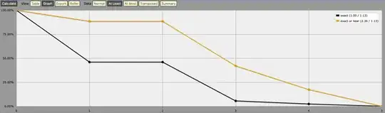

  • just plotting the distributions of the number of duplicates with and without near misses and comparing them, e.g. like this (using AnyDice in "at least" graphing mode, for 1d12 + 2d10 + 1d8):
    Screnshot of graph
    (Note: The one-in-10-billion "fuzz die" in the linked code above is there to work around what I'd consider a glitch in AnyDice's graph plotting. You can remove it and see how janky the graphs become due to missing values.)
