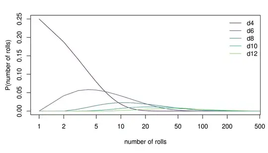

For d4 through d12, these distributions look like this (note that the x-axis is on the log scale: these distributions are quite broad!): PMF of the last psionic die
This also allows us to compute various summaries of the number of rolls before the psionic power die is lost: \begin{array}{c|l|l|l} \textbf{Die} & \textbf{mean} & \textbf{median} & \textbf{mode} & \textbf{95% probability interval} \\ \hline d4 & 4 & 2 & 1 & [1, 10] \\ d6 & 16 & 11 & 4 & [2, 43] \\ d8 & 40 & 29 & 11 & [3, 108] \\ d10 & 80 & 58 & 22 & [5, 217] \\ d12 & 140 & 103 & 39 & [8, 380] \end{array}

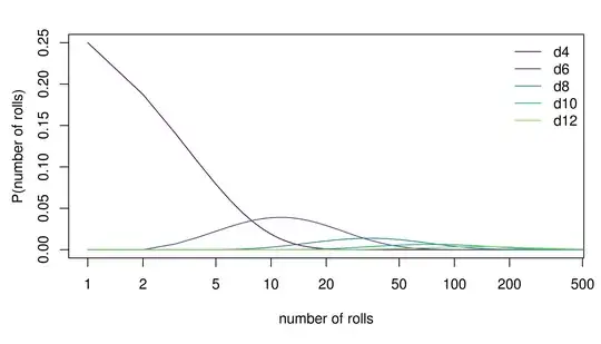

The resulting distributions and summaries are: enter image description here
\begin{array}{c|l|l|l} \textbf{Die} & \textbf{mean} & \textbf{median} & \textbf{mode} & \textbf{95% probability interval} \\ \hline d4 & 4 & 2 & 1 & [1, 10] \\ d6 & 22 & 17 & 11 & [3, 50] \\ d8 & 62 & 52 & 34 & [8, 139] \\ d10 & 132 & 112 & 75 & [18, 293] \\ d12 & 240 & 205 & 138 & [33, 531] \end{array}

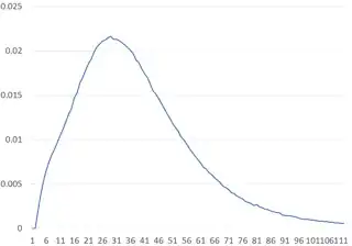

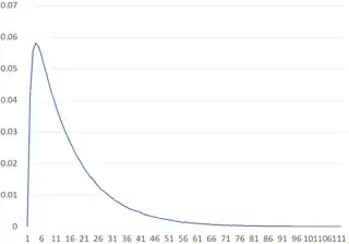

For a d6:
distribution of d6 psi dice

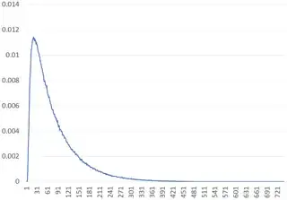

For a d10:
distribution of d10 psi dice

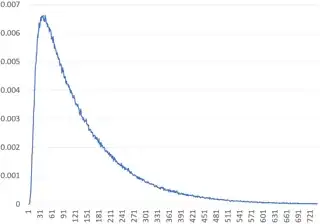

For a d12:
distribution of d12 psi dice
From these we can also get the average number of rolls we get to do with any one size of die:
\begin{array}{c|l} \textbf{Dice} & \textbf{Average number of rolls}\\ \hline d6 & 15.998\\ d8 & 40.021\\ d10 & 80.104\\ d12 & 140.0582 \end{array}

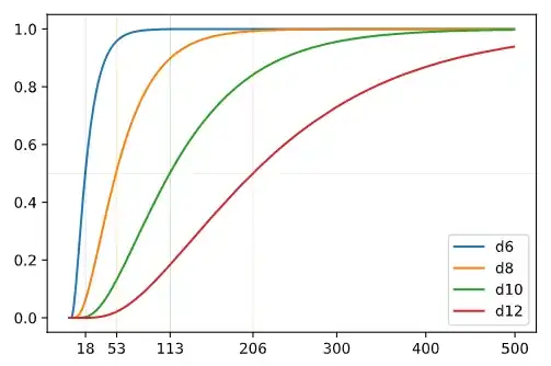

Here is the graph of the cumulative probability of the Psionic Die becoming unusable:
![![Probability of roll number by die size][1]
\begin{array}{c|l} \textbf{Dice} & \textbf{mean} & \textbf{min} & \textbf{5%} & \textbf{median}& \textbf{95%} \\ \hline d6 & 22 & 3 & 6 & 18 & 51\\ d8 & 62 & 5 & 17 & 53 & 139\\ d10 & 132 & 7 & 37 & 113 & 291\\ d12 & 240 & 13 & 69 & 206 & 526\\ \end{array}
