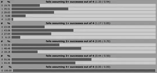

Of course, we can also modify the AnyDice code above to calculate the number of failures on \$k\$ or more successes. The screenshot below shows the output for \$n=4\$:
Screenshot
