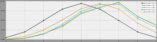

In graph mode, the outputs of this program look like this:
Graph
Note how the differences between skill levels 2, 3 and 4 are fairly minor, since rolling three or four -1s on 4dF is quite unlikely to begin with.

Graph
Note how the averages are still the same, but the results for higher skills have a lot more variance. In particular, the probabilities of rolling a perfect four with a positive skill are a lot higher this way.
(The only difference between the programs used to generate the two graphs above are that the second one uses [count {0, -1} in ROLL] instead of [count -1 in ROLL].)

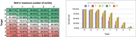

Exporting the output of this script and running it through the same Python script and spreadsheet gives the following heat map and bar graph:
Screenshot
As you can see, the results aren't actually that different from the sequential rerolls case. The biggest differences occur with high skills and intermediate target numbers: for example, with a skill of 4, being able to perform the rerolls one at a time and stop at any point raises the average success rate from 75.3% to 81% for a target of +1, or from 51.6% to 58.3% for a target of +2.

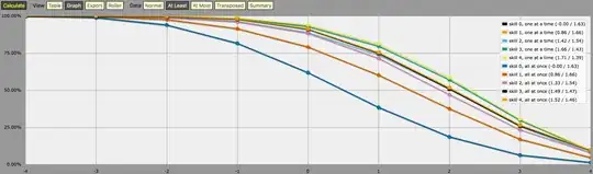

and a screenshot of the output (in "at least" line graph mode):
Graph
A note on the interpretation of the output generated by the program above: The probability distributions shown on the graph above don't correspond to the results of any single dice rolling strategy; rather, they are artificially constructed distributions (i.e. "custom dice" in AnyDice jargon) such that the probability of rolling at least \$N\$ on a single roll of the custom die equals the probability of the player being able to roll at least \$N\$ on 4dF with the given rerolling mechanic (one at a time vs. all at once) and the given maximum number of rerolls, assuming that the player uses the optimal rerolling strategy for that particular target \$N\$.
In other words, looking at the output in "at least" mode, we can see that a player with skill level 4 has a 51.62% chance of successfully rolling +2 or more (using the all-at-once rerolling mechanic) if they're using their available rerolls in the way that maximizes that particular chance. The output also correctly shows that the same player has a 75.28% chance of rolling +1 or more if they choose to optimize for that instead, but they'll need different rerolling strategies to reach those two goals.
And the "probability" of 23.65% for rolling exactly +1 on the custom die described above really has no sensible meaning, except that it's (approximately, due to rounding) the difference between 75.28% and 51.62%. Which I guess is why it's so hard to calculate with AnyDice. :P I suppose you could interpret it as a measure of how much harder a target of +2 is to meet using the given skill and rerolling mechanic than a target of +1, in some sense, but that's about it.
