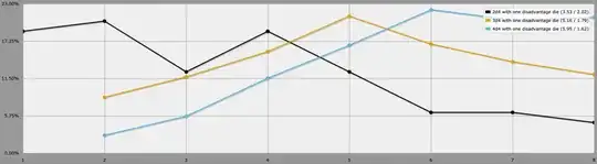

And here's the actual distribution of results with 2–4 normal dice and one disadvantage die:
Screenshot of AnyDice output
(The code linked above also calculates the results for 0 and 2 disadvantage dice, but if you graph them all at once, the result is just a mess of intersecting lines.)
