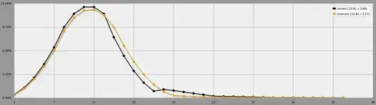

Ps. There actually is a way to kind of make AnyDice support if conditions based on dice, using a helper function like this:
function: if CONDITION:n then A else B {
  if CONDITION { result: A } else { result: B }
However, if you try to rewrite your code using this trick, something like this:
output [if [select 2 from X] = 6 then X + [explode d6] else X]
or even like this:
output X + [if [select 2 from X] = 6 then [explode d6] else 0]
you'll find that these programs give subtly incorrect results: the average will in fact be correct, but the standard deviation and the shape of the distribution graph will be subtly off:
AnyDice screenshot showing correct and incorrect results calculated using the methods described above
Experienced AnyDice users will, of course, quickly realize what the problem is: in the expressions above, each X represents a separate independent 3d6 roll. So the actual dice rolling mechanic that ends up being modelled here isn't "roll 3d6, then add an exploding d6 if you rolled at least two sixes", but rather "roll 3d6, then roll 3d6 again and add an exploding d6 if you rolled at least two sixes on the first 3d6 roll".
Of course, wrapping the code above inside a function, so that X becomes a sequence instead of a die, does make it work as intended:
function: evaluate X:s {
  result: [if [select 2 from X] = 6 then X + [explode d6] else X]
output [evaluate 3d6]
Basically, any time you want to implement a mechanic in AnyDice where you roll some dice and use the result of the roll more than once, you do need to write a function and pass the roll into it as a sequence parameter. That's the only way in AnyDice to "freeze" the result of a dice roll into a fixed sequence (or number).
