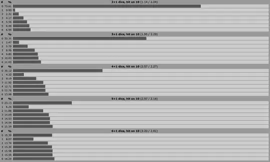

What about for more dice? As we can see, as the number of dice to choose from increases, the probability of getting stunts increases.
AnyDice screenshot

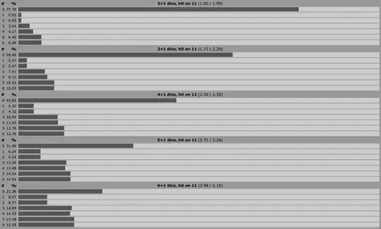

In general, higher stunt counts are more likely than lower ones, which makes intuitive sense: the higher you roll on the stunt die, the more likely you are to hit and to be able to choose a hitting combo that includes two identical dice. However, the specific shape of the curve varies depending on the target difficulty: DC 10 above, for example, gives fairly smooth looking plots, but DC 11 seems to favor odd numbers of stunts, leading to a more staircase-like graph:
AnyDice screenshot
Notably, for five or more normal dice and DC 11, the probability of getting a hit with stunts is actually slightly lower if you roll a 4 on the stunt die than if you roll a 3. (Of course you still get more stunts if you do get any, and your overall hit probability is higher too, so a higher roll on the stunt die is still better.)
