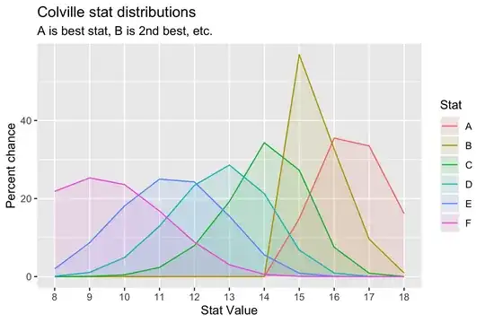

I went ahead and implemented this in R. You can see the code here: https://gist.github.com/DarwinAwardWinner/34dd19f302bd1ef24310f6098dc3218d
This code enumerates every possible roll of "4d6 drop lowest, reroll 7 or lower" in order to determine the exact probabilities of rolling each stat from 8 to 18. Then it uses these to compute the exact probability of rolling each possible set of 6 stats, rejecting stat sets without at least 2 stats 15 or higher. Interestingly, about 54% of stat rolls with all 8 or higher will not have 2 stats of 15 or higher, which means that for each stat roll, you have better than even odds of needing to reroll from scratch. Depending on how much your players enjoy rolling stats, this may be an advantage or a disadvantage.
Here's a plot of the distributions of each stat. A is whichever stat rolled highest, B is the 2nd highest, and so on, with F being the lowest stat. The Y axis the the probability of rolling a certain number. For example, your 2nd highest stat has about a 57% chance of being a 15, and a 0% chance of being anything lower than that (by definition).
Stat distribution plot
We can also get some statistics on the distributions. \$Q_{25}\$ and \$Q_{75}\$ are the 25th and 75th percentiles.
\begin{array}{l|r r r r r r} \textbf{Ability} & \textbf{Min} & \boldsymbol Q_{25} & \textbf{Median} & \textbf{Mean} & \boldsymbol Q_{75} & \textbf{Max} \\ \hline \text{A} & 15 & 16 & 16 & 16.5 & 17 & 18 \\ \text{B} & 15 & 15 & 15 & 15.5 & 16 & 18 \\ \text{C} & 8 & 13 & 14 & 14.0 & 15 & 18 \\ \text{D} & 8 & 12 & 13 & 12.7 & 14 & 18 \\ \text{E} & 8 & 10 & 11 & 11.3 & 12 & 18 \\ \text{F} & 8 & 9 & 10 & 9.8 & 11 & 18 \\ \end{array}
Of course, my code computes the full distribution for all possible stat rolls, so if you're curious about other facets of the data, such as point buy value, feel free to run the code and experiment.

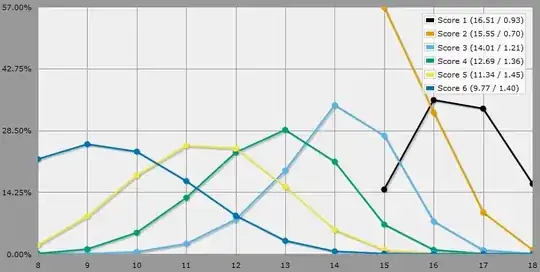

The following anydice program will show you what the statistical distribution of ability score results for the Colville method looks like.
function: roll ROLL:n min MIN:n{
 if ROLL < MIN { result: d{} }
 result: ROLL
function: colville ARRAY:s INDEX:n {
  if (ARRAY >= 15) < 2 { result: d{} }
  result: INDEX@ARRAY
ROLL: [highest 3 of 4d6]
SCORE: [roll ROLL min 8]
ARRAY: 6dSCORE
output [colville ARRAY 1] named "Score 1"
output [colville ARRAY 2] named "Score 2"
output [colville ARRAY 3] named "Score 3"
output [colville ARRAY 4] named "Score 4"
output [colville ARRAY 5] named "Score 5"
output [colville ARRAY 6] named "Score 6"
The trick here is that we don't actually want to have to reroll anything, because recursive functions are expensive and take forever (plus there's a limit to how far Anydice will recurse). Fortunately we actually have a really neat shortcut we can use in the specific case of rerolling until we get a result that's in the range we actually want; we can use a function as a filter to check the value is in the desired range, which returns the input value if it is, or the so-called empty die, d{}, if it is not.
The result of the empty die is basically discarded when anydice calculates probabilities, so we are shown results based only on rolls which met our parameters; since we were just going to reroll anyway until we got a result that was in our range, this is statistically identical to actually rerolling (potentially forever).
So we have two functions, one of which discards results for individual ability scores unless they are 8 or higher, one of which discards arrays of ability scores if there aren't two scores of 15 or more.
The other trick is that the latter function also takes an index to return one of those ability scores since unfortunately we can't get anydice to return a sequence from a function, only a flat number, and we so have to use the index to inspect the individual rolls; fortunately the generated sequence is automatically sorted in descending order by default, so we can just iterate through each position to build a complete distribution.
That gives us a result that looks like this when graphed:
Colville stat distribution graph from anydice
This seems to agree perfectly with Ryan Thompson's R-based answer so I feel pretty confident I haven't messed up how this works anywhere.

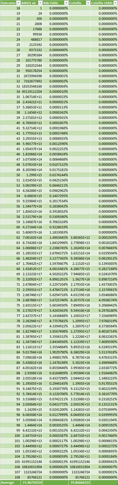

Well, we could compare the total statpoint distribution, against a normal 6x(4d6D1) rolled stats:
Posted as an image because I was overloading Mathjax
So it turns out the Colville Method has a pretty consderable boost to the overall sum, raising the average from 73.468 to 79.867. This isn't surprising though: all the data it acts on (individual rolls below 8, any set that is does not have at least two ≥15 rolls) are specifically bad rolls, so it naturally tends towards higher results.
If you use the dataset I posted above, you're welcome to do your own analysis on it. I recommend heavy use of Microsoft Excel or some other Spreadsheet software.
