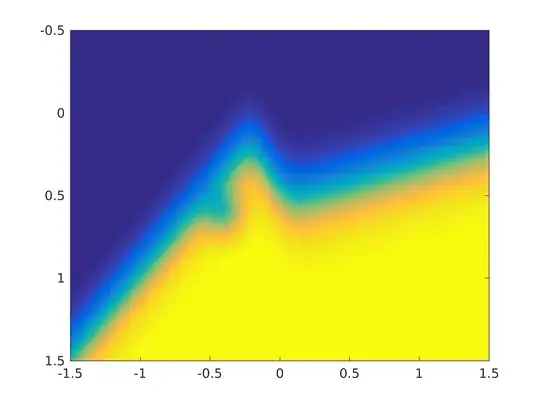

So say we record the amount of time the customer spends "sniffing eggs" and "holding a book with omelette recipes" and make ourselves a classification task:
This is actually my version of Brian Ripley's synthetic benchmark dataset, but lets pretend it is the data for our task. As this is a synthetic task, I can work out the probabilities of class membership according to the true data generating process:
Unfortunately it is upside-down because I couldn't work out how to fix it in MATLAB, but please bear with me. Now in practice, we won't get a perfect model, so here is a model with an error (I have just perturbed the true posterior probabilities with a Gaussian bump).
And here is another one, with a bump in a different place.
Now the Brier score is a proper scoring rule, and it gives a slightly lower (better) score for the second model (because the perturbation is in a region of slightly lower density). However, the perturbation in the first model is well away from the decision boundary, and so that one has a higher accuracy.

One of the problems of accuracy is that it ignores the intrinsic difficulty in the data-generating mechanism. Here, the difficulty refers to the uncertainty of the label, which can be measured by its variance. The point is that when assessing a classifier, a misclassification can be due to high uncertainty of the data-generating mechanism instead of the flaw of the model.
For instance, we predict $Y\in\{0,1\}$ from $X\in \mathcal X$. Assume that there is an unknown data-generating probability function $P(Y=1\mid X=x)$, $x\in\mathcal X$. The variance $$Var(Y=1\mid X=x)=P(Y=1\mid X=x)(1-P(Y=1\mid X=x)),$$ which is maximized when $P(Y=1\mid X=x)=0.5$ and minimized when $P(Y=1\mid X=x)=0$ or $1$. Suppose $\exists x_1,x_2\in\mathcal X$ such that $$ P(Y=1\mid X=x)= \begin{cases} 0.5&\ \text{when } x=x_1,\\ 0.99&\ \text{when } x=x_2. \end{cases} $$ When evaluating the performance of a classifier, a misclassification at $x_1$ should be considered less severe than a misclassification at $x_2$. However, this problem of heteroscedasticity in variance is not reflected in accuracy. Also, the best possible accuracy depends on the $P(Y=1\mid X=x)$ and can be very different on different data sets.
To take the unknown $P(Y=1\mid X=x)$ into account and assess how well the classifier performance compared with the best possible performance, we may apply goodness-of-fit tests, e.g., Pearson's chi-squared test, Residual deviance test, and Hosmer–Lemeshow test. Although the majority of the goodness-of-fit tests only apply to parametric models, there is a recent work Is a Classification Procedure Good Enough?—A Goodness-of-Fit Assessment Tool for Classification Learning that addresses the evaluation problem of general classifiers.

  • @Tim Sorry for the lack of clarification. The difficulty refers to the uncertainty of the label $Y$, which can be measured by its variance $P(Y=1\mid X=x)(1-P(Y=1\mid X=x))$. My point is that a misclassification can be due to the high uncertainty of $Y$, e.g., both $P(Y=1\mid X=x)$ and $P(Y=0\mid X=x)$ equal 0.5, instead of the problem of the classifier. Therefore, it would be ideal if we can also take this uncertainty into account when assessing a classifier. – augustin4 Oct 21 '23 at 16:56
  • It's probably worth putting this in your answer. – Tim Oct 21 '23 at 20:15
  • @Tim Thank you for your suggestion! I have made an update. – augustin4 Oct 22 '23 at 01:50
