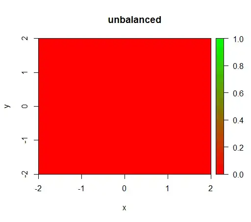

Question in one sentence: Does somebody know how to determine good class weights for a random forest?
Explanation: I am playing around with imbalanced datasets. I want to use the R package randomForest in order to train a model on a very skewed dataset with only little positive examples and many negative examples. I know, there are other methods and in the end I will make use of them but for technical reasons, building a random forest is an intermediate step. So I played around with the parameter classwt. I am setting up a very artificial dataset of 5000 negative examples in the disc with radius 2 and then I sample 100 positives examples in the disc with radius 1. What I suspect is that
1) without class weighting the model becomes 'degenerate', i.e. predicts FALSE everywhere.
2) with a fair class weighting I will see a 'green dot' in the middle, i.e. it will predict the disc with radius 1 as TRUE although there are negative examples.
This is how the data looks like:
This is what happens without weighting: (call is: randomForest(x = train[, .(x,y)],y = as.factor(train$z),ntree = 50))
For checking I have also tried what happens when I violently balance the dataset by downsampling the negative class so that the relationship is 1:1 again. This gives me the expected result:
However, when I compute a model with a class weighting of 'FALSE' = 1, 'TRUE' = 50 (this is a fair weighting as there are 50 times more negatives than positives) then I get this:
Only when I set the weights to some weird value like 'FALSE' = 0.05 and 'TRUE' = 500000 then I get senseful results:
And this is quite unstable, i.e. changing the 'FALSE' weight to 0.01 makes the model degenerate again (i.e. it predicts TRUE everywhere).
Question: Does somebody know how to determine good class weights for a random forest?

  • if sampsize works why not use that? I also found sampsize works better to resolve this, as did others. Also see a great answer here https://stats.stackexchange.com/questions/157714/r-package-for-weighted-random-forest-classwt-option – katya Jun 01 '17 at 21:35
  • daply is in plyr, you should call that. – EngrStudent Jun 05 '17 at 18:57
  • classwt Priors of the classes. Need not add up to one. Ignored for regression. – Diego Jul 20 '18 at 17:41
  • @Diego: This parameter seems to be very problematic, I do not understand how this parameter behaves (see the comments in the question!)... – Fabian Werner Jul 20 '18 at 18:27
Don't use a hard cutoff to classify a hard membership, and don't use KPIs that depend on such a hard membership prediction. Instead, work with a probabilistic prediction, using predict(..., type="prob"), and assess these using proper .
This earlier thread should be helpful: Why is accuracy not the best measure for assessing classification models? Unsurprisingly enough, I believe my answer would be particularly helpful (sorry for the shamelessness), as would an earlier answer of mine.
