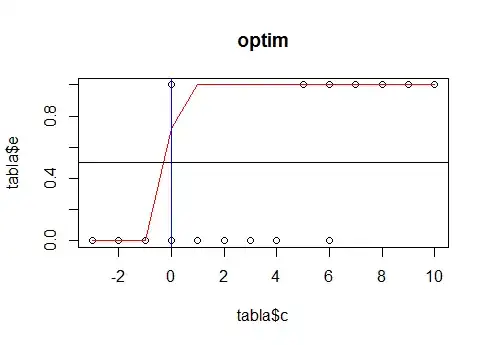

An the other model would be:
    plot(tabla$c, tabla$e, main="optim")
    lines(tabla$c, tabla$pred_guess, col="red")
    abline(0.5, 0)
    abline(v=min(tabla$c[tabla$pred_guess>0.5]), col="blue")
optim model and threshold selection
