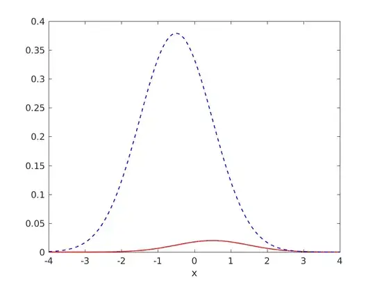

In cases where there is a substantial difference in relative class frequencies, it could be that the density of the minority class is never higher than the density of the majority class anywhere in the attribute space. Here is a simple example using univariate Gaussian classes, with an imbalance ratio of 1:9.
In this case, if my classifier assigns all patterns to the majority class, it is doing exactly the right thing, and there is no problem to solve.
In this case, we know the true data generating process, so we know that the classifier is doing the right thing. However in general we don't know the true distributions of positive and negative classes, so we don't know whether the classifier is doing the right thing or not.
So my question is: In practical applications, how do we decide if we have a class imbalance problem, or whether the classifier is just giving the correct answer, to the question as posed?
Full disclosure: My intuition is that in most cases, especially when the data is not unduly scarce, the classifier is doing exactly what it should do and there is no class imbalance problem. I am primarily interested to hear how other practitioners and researchers diagnose class imbalance problems.

    @Dave In this instance it is doing the right thing, but it is not that difficult to construct cases where there is a non-trivial decision boundary and the classifier is biased against the positive class. I am asking how practitioners decide which is which in their application (or indeed if they do decide). A lot of the answers relating to class imbalance here are rather, err, imbalanced, one way or the other, and it is rather more of a nuanced issue than seems to be appreciated. – Dikran Marsupial Aug 09 '21 at 15:39
    Could you give an example of what you mean by the decision boundary being non-trivial and the classifier (probability model...) being biased against the positive class? I do not follow. – Dave Aug 09 '21 at 15:45
  • just move the red distribution to the right until it just peeks out from under the blue one. At that point there will be an area of the attribute space that the classifier should assign to the positive class, but the "class imbalance problem" may result in the classifier failing to do so. – Dikran Marsupial Aug 09 '21 at 15:51
    You do that knowing the true populations. When we do not know the true populations, we have to rely on signal-to-noise ratio. Until that becomes very strong, what business do we have in going strongly against the prior probability that favors blue? If we have excellent estimates of both the red and blue distributions, we will be able to get red to peak through and be identified as more likely to be red. – Dave Aug 10 '21 at 13:49

    It’s not possible to have a density smaller than the other at all points as the area is 1 for both. Am I missing something? – gunes Jun 14 '22 at 17:48
  • @gunes, the p.d.f. of each class needs to be weighted by the prior probability. It is the sum of the two densities that integrates to 1. Good point though, I obviously didn't make that clear so I need to edit the question when I have a moment, many thanks for the useful comment! – Dikran Marsupial Jun 14 '22 at 18:02

    This does not address the question. In practice we do not know the true distributions. The class imbalance problem is an estimation problem - we don't know the true parameters of the distribution and have to estimate them from the data. If the error in those estimates cause a bias in the decision threshold that goes against the minority class, we have an example of the class imbalance problem. That cannot be demonstrated by an example where the true parameters are known. I want to know how people diagnose a class imbalance problem in operational use. – Dikran Marsupial Aug 11 '21 at 06:52
  • The point of my diagram was to show that we can't use all patterns being assigned to the majority class as an indication of a class imbalance problem because sometimes that is the optimal solution. So how do we rule out that possibility? How do we decide to use resampling or re-weighting? I suspect in a lot of cases these techniques are used simply because people are following a roadmap/recipe and are making their classifier worse by "correcting" an already optimal classifier. However, it may be that there is a diagnostic method I don't know about. – Dikran Marsupial Aug 11 '21 at 07:02
