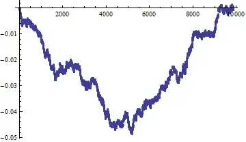

There are many ways to check uniformity. A neat way, although somewhat computationally intensive, is with Ripley's K function. The expected number of points within (3D Euclidean) distance $\rho$ of any location on the sphere is proportional to the area of the sphere within distance $\rho$, which equals $\pi\rho^2$. By computing all interpoint distances you can compare the data to this ideal.
General principles of constructing statistical graphics suggest a good way to make the comparison is to plot variance-stabilized residuals $e_i(d_{[i]} - e_i)$ against $i = 1, 2, \ldots, n(n-1)/2=m$ where $d_{[i]}$ is the $i^\text{th}$ smallest of the mutual distances and $e_i = 2\sqrt{i/m}$. The plot should be close to zero. (This approach is unconventional.)
Here is a picture of 100 independent draws from a uniform spherical distribution obtained with the first method:
100 uniform spherical points
Here is the diagnostic plot of the distances:
Diagnostic plot
The y scale suggests these values are all close to zero.

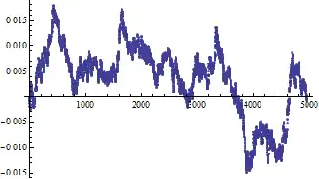

Here is the accumulation of 100 such plots to suggest what size deviations might actually be significant indicators of non-uniformity:
Simulated values
(These plots look an awful lot like Brownian bridges...there may be some interesting theoretical discoveries lurking here.)
