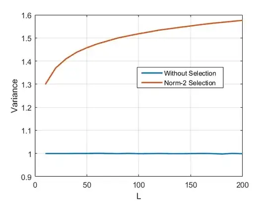

I know the distribution of $\max ||\vec{h_k}||^2 $, but I want to know what happens to the argument? I have done some simulation (100000 trials). Looks like $\vec{h^*}$ still follows the Gaussian distribution with mean zero. And the variance of $\vec{h^*}$ i.e., $ E[\big(\vec{h^*} - E[\vec{h^*}]\big)^2]$ looks like this:
Variance
I was wondering if there is an exact and/or bound formula for the variance? Is it possible to prove that the selected vector still a Gaussian?
