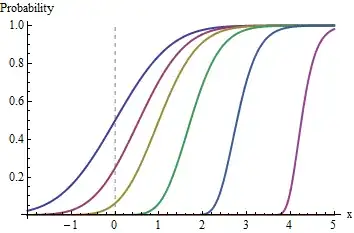

When the support of $F$ has no upper bound, as with a Normal distribution, the sequence of functions $F^n$ marches forever to the right without limit:
Figure 1
Partial graphs of $F_n$ for $n=1,2,2^2, 2^4, 2^8, 2^{16}$ are shown.
