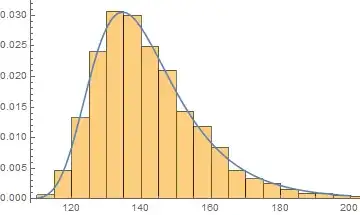

For your particular example, here are the Mathematica commands:
x = Max[#] & /@ RandomVariate[LogNormalDistribution[3.2, 0.4], {1000, 100000}];
Show[Histogram[x, Automatic, "PDF"],
 Plot[PDF[OrderDistribution[{LogNormalDistribution[3.2, 0.4], 100000}, 100000], z], {z, 110, 200}]]
Histogram and pdf
