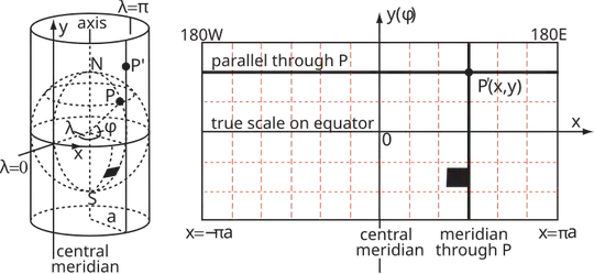

You can consider the n-sphere sphere as a sum of (n-1)-spheres, slices/rings/frustrums.
Now we project a point from the n-sphere, onto the n-cylinder around it. Below is a view of the idea in 3 dimensions.
https://en.wikipedia.org/wiki/File:Cylindrical_Projection_basics.svg
The trick is then to sample the height on the cylinder and the direction away from the axis separately.
Without loss of generality we can use the coordinate $(1,0,0,0,...,0)$ (solve it for this case and then rotate the solution to your point $X$).
Then use the following algorithm:
  • Sample the coordinate $x_1$ by sampling which slices the points end up in according to some desired distance function.
  • Sample the coordinates $x_2, ..., x_n$ by determining where the points end up on the (n-1)-spheres (this is like sampling on a (n-1)-dimensional sphere with the regular technique).
Then rotate the solution to the point $X$. The rotations should bring the first coordinate $(1,0,0,0, ..., 0)$ to the vector $X$, the other coordinates should transform to vectors perpendicular to $X$, any orthonormal basis for the perpendicular space will do.
    How do you achieve a close approximation to a Normal distribution? – whuber Apr 27 '20 at 13:05
    @whuber I did not write down explicitly how to achieve this, since this is not clear to me what 'a close approximation to a Normal distribution' is supposed to mean. Also, I do not recognise this in the OP's question. I just gave a general formalism. For any distribution function of the distance (which is obviously limited by the half the circumference), you can use this algorithm. One only has to sample from this distance-distribution and after that compute the coordinate $x_1$ (or the height on the cylinder) based on that distance. – Sextus Empiricus Apr 27 '20 at 13:37
    The problem is that "compute the coordinate" can introduce extreme distortion. As far as "close approximation" goes, that seems intuitively clear, although it is open to various different mathematical interpretations: but at a minimum, you should offer one reasonable interpretation and show why your proposal satisfies that criterion. – whuber Apr 27 '20 at 13:40
    @whuber where does this criterion come from? I have just given an algorithm to compute a distribution for any given distance distribution. Also, not that it is not an approximation, it is an exact solution. – Sextus Empiricus Apr 27 '20 at 13:42
    To be honest, I have not looked into extremely high dimensions whether this "compute the coordinate $x_1$" may generate computational errors. Is that what you are pointing at? – Sextus Empiricus Apr 27 '20 at 13:45
  • I see two flaws in that, but one is debatable; namely, the interpretation of "I can create random points with a Gaussian ... efficiently creating points like these?" That is the basis for assuming the OP wants points closely following some Gaussian distribution. The fatal flaw, though, is that your procedure does not indicate how to produce any desired distribution on the sphere. For instance, how exactly would it proceed if you wanted, say, a uniform distribution on the sphere? – whuber Apr 27 '20 at 13:46
    @whuber in the case of the uniform distribution the sampling is according to the relative area of the different (n-1) spheres/slices at the height of the coordinate $x_1$. That is a beta-distribution (the beta function also turns up here). – Sextus Empiricus Apr 27 '20 at 13:56
  • Right--and that's the easy case. The point is that some procedure is required to translate the desired distribution on the sphere into a workable algorithm. The details matter. (The details of rotating the sphere matter, too, whenever the distribution is not isotropic around the central point $X.$) – whuber Apr 27 '20 at 14:53
    @whuber the OP's question is very thin on these details. I have just provided a simple method for the case when we can describe the distribution as an isotropic/uniform distribution with the only density variation based on distance from the point. Yes, if anisotropy is involved (but only a single point $X$ is given so this does hijack the OP's question) then the method for rotation needs to be adjusted and requires additional axes/points to determine the rotation (this is the same for any method). If such details are implicitly considered, then the question becomes too broad and unclear. – Sextus Empiricus Apr 27 '20 at 15:48
