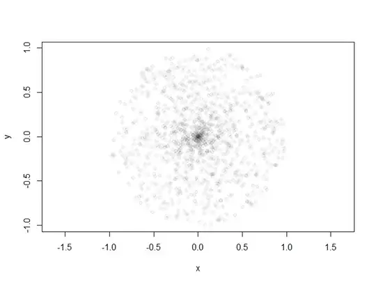

I have to randomly generate 1000 points over a unit disk such that are uniformly distributed on this disk. Now, for that, I select a radius $r$ and angular orientation $\alpha$ such that the radius $r$ is a uniformly distributed variate from $r \in [0,1]$ while $\alpha$ is a uniformly distributed variate from $\alpha \in [0, 2\pi]$ using the following code
r <- runif(1000, min=0, max=1)
alpha <- runif(1000, min=0, max=2*pi)
x <- r*cos(alpha)
y <- r*sin(alpha)
plot(x,y, pch=19, col=rgb(0,0,0,0.05), asp=1)
Then I look at my sample space and it looks like this:
Sample_space_1
This obviously doesn't look like a sample with uniform distribution over the disk. Hence, I guessed that the problem might be occurring as a result of a lack of independence between the variables $r$ and $\alpha$ in contingency to how they've been linked computationally.

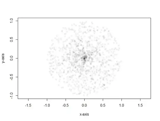

To take care of that I wrote a new code.
rm(list=ls())
r <- runif(32, min=0, max=1)
df_res <- data.frame(matrix(c(-Inf, Inf), byrow = T, nrow = 1))
for (i in 1:32) {
  for (j in 1:32) {
    alpha <- runif(32, min=0, max=2*pi)
    df <- data.frame(matrix(c(r[i],alpha[j]), byrow = T, nrow = 1))
    df_res <- rbind(df_res,df)
df_res <- subset(df_res, df_res$X1 != -Inf)
x<- df_res$X1 *cos(df_res$X2)
y <- df_res$X1 *sin(df_res$X2)
And, yet again the sample looks non-uniformly distributed over the disk
Sample_space_2
I'm starting to suspect that there is a deeper mathematical problem going on in the vicinity. Could someone help me write code that would create a sample space uniformly distributed over the disk, or explain the mathematical fallacy if any in my reasoning?

    By taking an angle you're splitting the circle into slices. The problem is that these slices are narrower at the centre, and this keeps being a problem no matter how thin the slices are. Then you select a radius, which will, with equal probability, put points into the thin part at the centre and the thicker parts further from the centre. So then the area in the centre will have more points compared to some area further from the centre. This applies to the first approach at least, I don't know R (or whatever) well enough to follow the second approach. – Bernhard Barker Aug 05 '20 at 16:12

The problem is due to the fact that the radius is not uniformly distributed. Namely, if $(X,Y)$ is uniformly distributed over $$\left\{ (x,y);\ x^2+y^2\le 1\right\}$$ then the (polar coordinates) change of variables $$R=(X^2+Y^2)^{1/2}\qquad A=\text{sign}(Y)\arccos(X/R)$$ has the density $$\frac{1}{\pi} \mathbb{I}_{(0,1)}(r)\left|\frac{\text{d}(X,Y)}{\text{d}(R,A)}(r,\alpha)\right|\mathbb{I}_{(0,2\pi)}(\alpha)$$ Using $x = r \cos \alpha$ and $y = r \sin \alpha$ leads to $$\left|\frac{\text{d}(X,Y)}{\text{d}(R,A)}(r,\alpha)\right|=r(\sin^2\alpha+\cos^2\alpha)=r$$ Therefore, the angle $A$ is distributed uniformly over $(0,2\pi)$ but the radius $R$ has density $f(r)=2r\mathbb{I}_{(0,1)}(r)$ and cdf $F(r)=r^2$ over $(0,1)$. As one can check by running
r <- sqrt(runif(1000, min=0, max=1) )
x <- r*cos(alpha)
y <- r*sin(alpha)
where the radius is simulated by the inverse cdf representation, which makes it the square root of a Uniform variate, the random repartition of the 10³ simulated points is compatible with a uniform:
