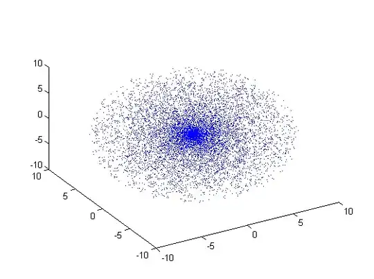

With respect to post (1) and post (2), I generated a large number of uniformly distributed points inside the ball of radius $R$ using $\frac{R_s U^{1/3}}{\sqrt{X_1^2 + X_2^2 + X_3^2}} (X_1, X_2, X_3)$, where $U$ is uniformly distributed between 0 and 1, and $X_1, X_2, X_3$ are independent normal random variables with mean 0 and variance 1. The following figure shows a uniform spherical distribution obtained by this method using 10000 independent draws in a sphere of radius 10. enter image description here
By computing the nearest neighbour distance $d_i$ of every point, I observed that the diagnostic plot of nearest neighbour distances does not follow a uniform distribution. Does this non-uniform distribution mean that one can cluster the points? Does it mean points dont have spatial randomness? If so, then how can I generate random points with uniform nearest neighbour distances.
Temporary images for @Anony-Mousse consideration: enter image description here enter image description here

    The very picture shows that the distribution is not uniform, it is more dense in the centre. In what sense is it uniform to you? – ttnphns Feb 05 '14 at 12:04
  • @ttnphns yes, you are right. Randomness of $d$ is important for me. I want to avoid point clustering based on nearest neighbor distance metric. – Jolfaei Feb 05 '14 at 12:17
  • If I find the best fit for the empirical distribution of $d$, then I can check the randomness with respect to that distribution. If this test is passed, then can I say that point clustering is infeasible by nearest neighbour metric? – Jolfaei Feb 05 '14 at 12:24
    I was speaking not about randomness, but about uniformity. Am I right in that you want a ball of points uniformly populating inside the ball - i.e. like a solid ball of iron? – ttnphns Feb 05 '14 at 12:27
  • @ttnphns I guess you want to make a point. What do you mean by a solid ball of iron? Do you mean homogeneous distribution of points? in that case yes. – Jolfaei Feb 05 '14 at 13:30

    @ttnphns Those points appear to be correctly generated and distributed. They look more concentrated in the center because the sphere is thicker in the center. – whuber Feb 05 '14 at 22:59

  • I have done a test with MATLAB. Using the method explained above I generated 10000 independent points in a sphere of radius 10. I calculated the nearest neighbour distance for all points. Using the curve fitting tool of MATLAB, I found that the best fit for the empirical distribution of nearest neighbours is Nakagami distribution. – Jolfaei Feb 06 '14 at 10:06

  • "When your sample was Nakagami distributed, than the squared distances should be Gamma distributed, right?", correct. Please see the temporary images that I added to the question. – Jolfaei Feb 06 '14 at 14:03
