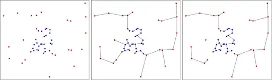

The second approach is less conventional and uses minimum spanning trees. The initial work was performed by Friedman & Rafsky in 1979 (reference in the package) to test whether two multivariate samples come from the same distribution. The image below illustrates the principle.
uniformity
Points from two bivariate samples are plotted in red or blue, depending on their original sample (left panel). The minimum spanning tree of the pooled sample in two dimensions is computed (middle panel). This is the tree with minimum sum of edge lengths. The tree is decomposed in subtrees where all the points have the same labels (right panel).
In the figure below, I show a case where blue dots are aggregated, which reduces the number of trees at the end of the process, as you can see on the right panel. Friedman and Rafsky have computed the asymptotic distribution of the number of trees that one obtains in the process, which allows to perform a test.
non uniformity
This idea to create a general test for uniformity of a multivariate sample has been developed by Smith and Jain in 1984, and implemented by Ben Pfaff in C (reference in the package). The second sample is generated uniformly in the approximate convex hull of the first sample and the test of Friedman and Rafsky is performed on the two-sample pool.
The advantage of the method is that it tests uniformity on every convex multivariate shape and not only on the hypercube. The strong disadvantage, is that the test has a random component because the second sample is generated at random. Of course, one can repeat the test and average the results to get a reproducible answer, but this is not handy.
