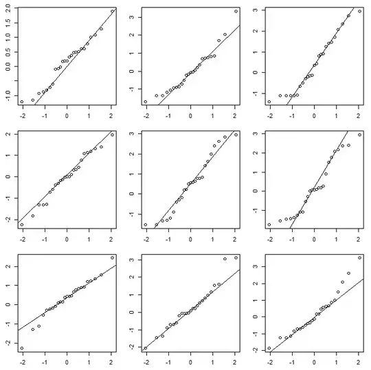

The short version of the idea (still read the paper for details) is that you generate data from the null distribution and create several plots one of which is the original/real data and the rest are simulated from the theoretical distribution. You then present the plots to someone (possibly yourself) that has not seen the original data and see if they can pick out the real data. If they cannot identify the real data then you don't have evidence against the null.
The vis.test function in the TeachingDemos package for R help implement a form of this test.
Here is a quick example. One of the plots below is 25 points generated from a t distribution with 10 degrees of freedom, the other 8 are generated from a normal distribution with the same mean and variance.
The vis.test function created this plot and then prompts the user to choose which of the plots they think is different, then repeats the process 2 more times (3 total).
Greg Snow
  • 51,722
  • @ScottStafford, I added a copy of the plot above. This one uses qqplots but the function will also generate histograms or density plots could be programmed. – Greg Snow Apr 18 '13 at 19:13
