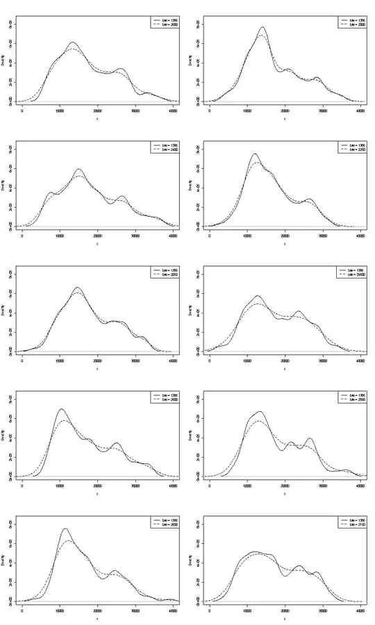

Following up on the ideas in @Nick's answer and comments, you can see how wide the bandwidth needs to be to just flatten out the secondary mode:
Take this kernel density estimate as the proximal null—the distribution closest to the data yet still consistent with the null hypothesis that it's a sample from a unimodal population—and simulate from it. In the simulated samples the secondary mode doesn't often look so distinct, and you needn't widen the bandwidth as much to flatten it out.
Formalizing this approach leads to the test given in Silverman (1981), "Using kernel density estimates to investigate modality", JRSS B, 43, 1. Schwaiger & Holzmann's silvermantest package implements this test, and also the calibration procedure described by Hall & York (2001), "On the calibration of Silverman's test for multimodality", Statistica Sinica, 11, p 515, which adjusts for asymptotic conservatism. Performing the test on your data with a null hypothesis of unimodality results in p-values of 0.08 without calibration and 0.02 with calibration. I'm not familiar enough with the dip test to guess at why it might differ.
R code:
      # kernel density estimate for x using Sheather-Jones
          # method to estimate b/w:
    density(x, kernel="gaussian", bw="SJ") -> dens.SJ
      # tweak b/w until mode just disappears:
    density(x, kernel="gaussian", bw=3160) -> prox.null
      # fill matrix with simulated samples from the proximal
      # null:
    x.sim <- matrix(NA, nrow=length(x), ncol=10)
    for (i in 1:10){
      x.sim[ ,i] <- rnorm(length(x), sample(x, size=length(x),
                          replace=TRUE), prox.null$bw)
      # perform Silverman test without Hall-York calibration:
    require(silvermantest)
    silverman.test(x, k=1, M=10000, adjust=F)
      # perform Silverman test with Hall-York calibration:
    silverman.test(x, k=1, M=10000, adjust=T)

The things to worry about include:
  1. The size of the dataset. It is not tiny, not large.
  2. The dependence of what you see on histogram origin and bin width. With only one choice evident, you (and we) have no idea of sensitivity.
  3. The dependence of what you see on kernel type and width and whatever other choices are made for you in density estimation. With only one choice evident, you (and we) have no idea of sensitivity.
Elsewhere I have suggested tentatively that credibility of modes is supported (but not established) by a substantive interpretation and by the ability to discern the same modality in other datasets of the same size. (Bigger is better too....)
We can't comment on either of those here. One small handle on repeatability is to compare what you get with bootstrap samples of the same size. Here are the results of a token experiment using Stata, but what you see is arbitrarily limited to Stata's defaults, which themselves are documented as plucked out of the air. I got density estimates for the original data and for 24 bootstrap samples from the same.
The indication (no more, no less) is what I think experienced analysts would just guess any way from your graph. The left-hand mode is highly repeatable and the right-hand is distinctly more fragile.
Note that there is an inevitability about this: as there are fewer data nearer the right-hand mode, it won't always reappear in a bootstrap sample. But this is also the key point.
Note that point 3. above remains untouched. But the results are somewhere between unimodal and bimodal.
For those interested, this is the code:
