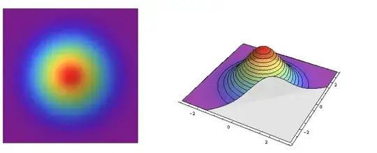

Figure 1: the standard bivariate normal distribution
The left side is a relief plot of the standard bivariate normal density. The right side shows the same in pseudo-3D, with the front part sliced away.
This is an example of a circularly symmetric distribution: the density varies with distance from a central point but not with the direction away from that point. Thus, the contours of its graph (at the right) are circles.
Most other bivariate Normal distributions are not circularly symmetric, however: their cross-sections are ellipses. These ellipses model the characteristic shape of many bivariate point clouds.

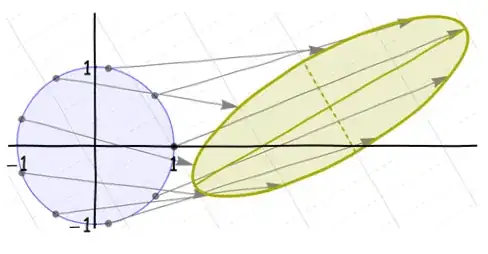

The key idea--one might venture to say it is the crux of regression--is that there is a way in which the circle can be distorted into an ellipse without rotating the vertical lines. Because the rotation was the culprit, let's cut to the chase and show how to created a rotated ellipse without actually appearing to rotate anything!
Skewed ellipse
This is a skew transformation. It does two things at once:
  • It squeezes in the $y$ direction (by an amount $\lambda$, say). This leaves the $x$-axis alone.
  • It lifts any resulting point $(x,\lambda y)$ by an amount directly proportional to $x$. Writing that constant of proportionality as $\rho$, this sends $(x,\lambda y)$ to $(x, \lambda y+\rho x)$.
The second step lifts the $x$-axis into the line $y=\rho x$, shown in the previous figure. As shown in that figure, I want to work with a special skew transformation, one that effectively rotates the ellipse by 45 degrees and inscribes it into the unit square. The major axis of this ellipse is the line $y=x$. It is visually evident that $|\rho| \le 1$. (Negative values of $\rho$ tilt the ellipse down to the right rather than up to the right.) This is the geometric explanation of "regression to the mean."
