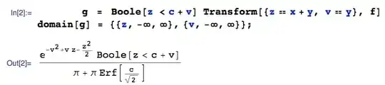

Given $f(x,y)$, consider the transformation $(Z = X+Y, V=Y)$.
If $X <c$ and $Z = X+Y$, then $Z < c + Y$. That is, $Z < c + V$. This dependency is invoked in the following line using the Boole statement. Then the joint pdf of $(Z,V)$, say $g(z,v)$ can be obtained with:
... where I am using the Transform function from mathStatica/Mathematica to automate the nitty-gritties using the Method of Transformations (Jacobian etc).
The pdf of $Z$ that we seek is simply the marginal pdf of $Z$:
... which is our desired closed form solution.
