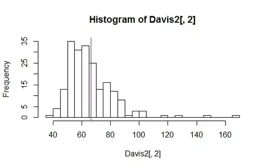

Of course, why not?
histogram with mean
Here's an example (one of dozens I found with a simple google search):
hist with mean and median
(Image source is is the measuring usability blog, here.)
I've seen means, means plus or minus a standard deviation, various quantiles (like median, quartiles, 10th and 90th percentiles) all displayed in various ways.
Instead of drawing a line right across the plot, you might mark information along the bottom of it - like so:
histogram with marginal boxplot
There's an example (one of many to be found) with a boxplot across the top instead of at the bottom, here.

As @gung surmised, abline(v=mean... was used to draw the mean-line across the plot and rug was used to draw the data values (though I actually used rug(jitter(... because the data was rounded to integers).
Here's a way to do the boxplot in between the histogram and the axis:
hist(Davis2[,2],n=30)
boxplot(Davis2[,2],
  add=TRUE,horizontal=TRUE,at=-0.75,border="darkred",boxwex=1.5,outline=FALSE)
I'm not going to list what everything there is for, but you can check the arguments in the help (?boxplot) to find out what they're for, and play with them yourself.
However, it's not a general solution - I don't guarantee it will always work as well as it does here (note I already changed the at and boxwex options*). If you don't write an intelligent function to take care of everything, it's necessary to pay attention to what everything does to make sure it's doing what you want.
