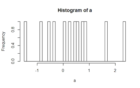

There really isn't any hard upper limit, but on the other hand, in most situations, once you get all unique observations in their own bin, finer bins only serve to pinpoint their positions more precisely without conveying much more. e.g. compare these:
histogram with 30 bins
histogram with 100 bins
Except in some very particular circumstances, there's likely to be no practical benefit in the second plot, and not that much in the first. If your data are continuous, this is probably way beyond a useful number of bins.
So in most situations, that seems like at least a practical upper bound - every unique observation in its own bin.
(If there is benefit in more bins than one per unique observation, you should probably be doing a rugplot or a jittered stripchart to get that kind of information) - something like what's done in the margins of these histograms:
histogram rugplot with jitter
histogram with stripchart
(Those histograms are taken from this answer, near the end)
