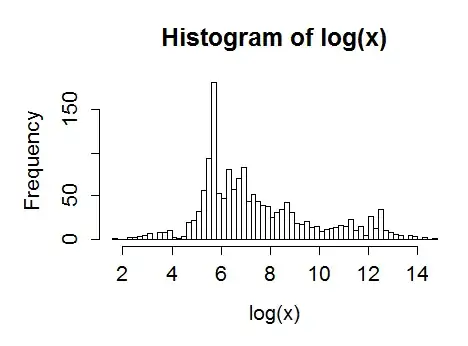

If you use R, there's a package for this. An example of a fit generated by it is here. Below is a histogram of the logs of the data set there, and reproductions of the logspline and kernel density estimates from the answer:
histogram of log-data

2) Finite mixture models. Here some convenient family of distributions is chosen (in many cases, the normal), and the density is assumed to be a mixture of several different members of that family. Note that kernel density estimates can be seen as such a mixture (with a Gaussian kernel, they're a mixture of Gaussians).
More generally these might be fitted via ML, or the EM algorithm, or in some cases via moment matching, though in particular circumstances other approaches may be feasible.
(There are a plethora of R packages that do various forms of mixture modelling.)
