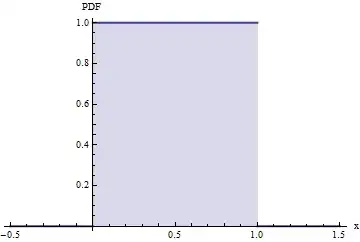

  3. The probability density function (PDF), which is the derivative of the CDF, is $f_X(x) = 1$ for $0 \le x \le 1$ and $f_X(x)=0$ otherwise. (It is undefined at $0$ and $1$.)
    PDF

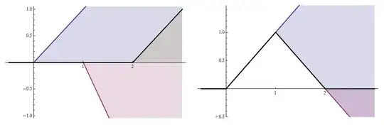

Graphs for n=2
The right panel shows the sum of these graphs (the solid black curve, normalized to have unit area: this is precisely the angular-looking PDF shown in the original question.
Now we can understand the nature of the "kinks" in the PDF of any sum of iid uniform variables. They are all exactly like the "kink" that occurs at $0$ in the function $\theta(t)t^{n-1}$, possibly rescaled, and shifted to the integers $1,2,\ldots, n$ corresponding to where the hyperplane $H_n(t)$ crosses the vertices of the hypercube. For $n=2$, this is a visible change in direction: the right derivative of $\theta(t)t$ at $0$ is $0$ while its left derivative is $1$. For $n=3$, this is a continuous change in direction, but a sudden (discontinuous) change in second derivative. For general $n$, there will be continuous derivatives through order $n-2$ but a discontinuity in the $n-1^\text{st}$ derivative.
