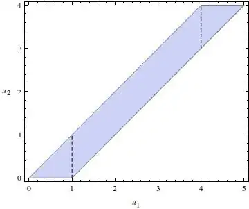

EDIT 2: I think I know where's the problem in my reasoning - in the integration limits. Because $y\in (0,4]$ and $x-y\in(0,1]$, I cannot simply $\int_0^x$. The plot shows the region I have to integrate in:
This means I have $\int_0^x$ for $y\in(0,1]$ (that's why part of my $f$ was correct), $\int_{x-1}^x$ in $y\in(1,4]$, and $\int_{x-1}^4$ in $y\in (4,5]$. Unfortunately, Mathematica fails to compute the latter two integrals (well, it does calculate the second, by there's an imaginary unit in the output that spoils everything...).
EDIT 3: It appears that Mathematica CAN compute the last three integrals with the following code:
(1/4)*Integrate[((1-Sqrt[u1-u2])*Log[4/u2])/Sqrt[u1-u2],{u2,0,u1}, Assumptions ->0 <= u2 <= u1 && u1 > 0]
(1/4)*Integrate[((1-Sqrt[u1-u2])*Log[4/u2])/Sqrt[u1-u2],{u2,u1-1,u1}, Assumptions -> 1 <= u2 <= 3 && u1 > 0]
(1/4)*Integrate[((1-Sqrt[u1-u2])*Log[4/u2])/Sqrt[u1-u2],{u2,u1-1,4}, Assumptions -> 4 <= u2 <= 4 && u1 > 0]
which gives a correct answer :)
