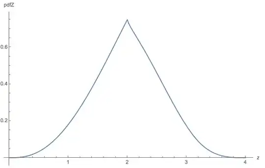

The resulting distribution should look like this: enter image description here

Here is a plot of the exact theoretical pdf of $Z$:
Monte Carlo check
The following diagram compares an empirical Monte Carlo approximation of the pdf (squiggly blue) to the theoretical pdf derived above (red dashed). Looks fine.

Just after reading wolfies answer I understood I could calculate the final distribution from the very beginning without all the mid-point steps:
M[x_] := M[x] = Evaluate@FullSimplify@ Integrate[ Boole[a + d + Sqrt[(a - d)^2 + 4 b c] <= x], {a, 0, 1}, {b, 0, 1}, {c, 0, 1}, {d, 0, 1}] gives the CDF and
m[x_] := m[x] = Evaluate@FullSimplify@D[M[x], x] gives the PDF that works perfect with my simulation:
This uses directly the approach of an answer to my previous question.
