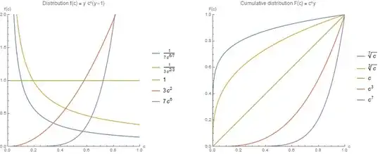

If it helps, assume $f(c)=\gamma c^{\gamma-1}$ and $F(c)=\int_{0}^{c} f(c')dc'=c^{\gamma}$, as depicted in the following figure.
Distributions

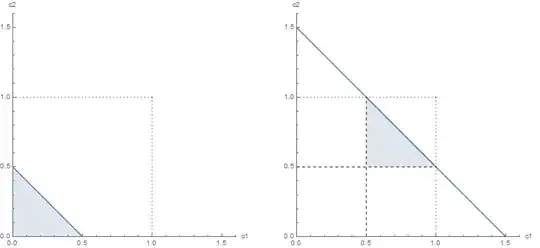

Imagine, first of all, the $d=2$ scenario. If $a<1$, for example, $a=0.5$, then doing the first integral leads to $\tilde{f}(0.5)=\int_{0}^{1}f(c_{1})f(0.5-c_{1})dc_{1}$. This leads to integrating over $f(c)$ for negative values of the argument $c$, where $f(c)$ is not defined. A solution would be to reduce $stop$ to $a$.
If $a>1$, for example, $a=1.5$, then doing the first integral leads to $\tilde{f}(1.5)=\int_{0}^{1}f(c_{1})f(1.5-c_{1})dc_{1}$. This leads to integrating over $f(c)$ for too high values of the argument $c$, where $f(c)$ is not defined. A solution would be to increase $start$ to $a-1$.
Figure1

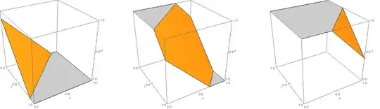

For $d=3$, the problem become even more complex. If $a<1$, a similar problem with integrating over too low values occurs. If $a>2$, a similar problem with integrating over too high values occurs. If $1<a<2$, then both the $start$ and the $stop$ need to be adjusted to prevent the integration from going into undefined areas.
Figure2

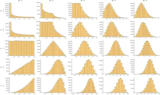

Numerical simulations using Mathematica give the following plots: Numerical Simulation
myFInverse[f_,\[Gamma]_]:=f^(1/\[Gamma])
myRandomTable[d_,n_,\[Gamma]_]:=Table[myFInverse[RandomReal[1,d],\[Gamma]],{i,1,n}]
Grid[Prepend[MapThread[Prepend,{Table[Histogram[Total[myRandomTable[d,100000,\[Gamma]],{2}],ImageSize->250],{\[Gamma],{1/3,1/2,1,2,3}},{d,1,5}],Table["\[Gamma]: "<>ToString[\[Gamma],StandardForm],{\[Gamma],{1/3,1/2,1,2,3}}]}],Prepend[Table["d: "<>ToString[d],{d,1,5}],""]]]
