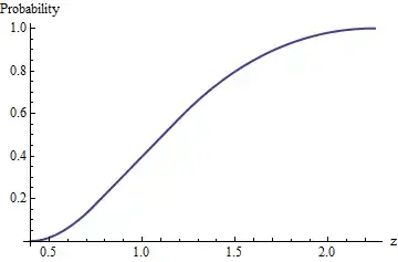

To illustrate its use, we may plot the CDF:
With[{a = 8/10, b = 3/2, c = 1/2, d = 3/2},
 Plot[(g[z, a,c] - g[z, a,d] - g[z, b,c] + g[z, b,d] )/((b-a)(d-c)), {z, a c, b d}]]

    wonderful. It works like a charm.
