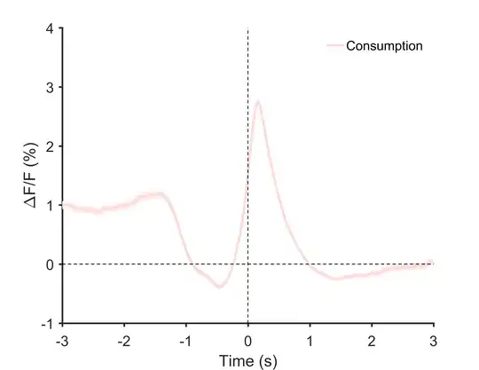

As I mentioned, Figure 1 is merely a snapshot of the data - a represenation of a single "trial". In the course of a 75 minute session, our mice perform hundreds of these trials, so I can either segment the long trace into individual "trials" from single sessions, or consider the entire session as one unit. As I mentioned, my main question is how I can quantify the immediate and transient effects of each intervention on the signal profile. Let us take the "Consumption" Event as an example. When observing the experiment I noticed an unambiguous decrease in the signal every time the mouse was given a reward. Let us say that the mouse that produced the above traces did 300 trials and thus had 300 of those consumption events in a single session. If I align the consumption events and average the signals together to eliminate sporadic noise, the characteristic response pattern to the intervention that I observed as the animal was behaving reveals itself:
Figure 4: Note that this figure does have errorbars around it, they are just small due to the large number of averaged trials. x = 0 corresponds to the consumption event
As you can see, once the event registers, there is a short delay followed by an unambiguous downward trend. I chose to fit an ARIMAX model to my data in order to account for the fact that the signal we see at any given moment is influenced by past events (that is, the signal isn't a perfect representation of internal state, but a representation of internal state contaminated by previous internal state). My thought was that this model would be most appropriate because it would let me take into account not just the lagged effects of previous signals, but also the intervention effects of external events given those lagged effects. You will note for instance that in figure 1, there are 5 external events that I am interested in profiling and each has a distinct profile as in figure 4. The time between the different external events varies from trial to trial, though they occur in the same order on every trial. My two main concerns in analyzing the data using a simpler method than the ARIMAX is that 1)the effects of adjecent events may overlap in either an opposing or additive fashion 2)because of trial to trial variability I can't simply look at the amplitude of the signal -for example, the consumption event in figure a starts when y = 7, but you can see that in figure 4 the amplitude of the averaged peak is < 3. Because of this variability I thought taking into account previous signal history and looking for impulse and transitory effects was the most ideal model.
