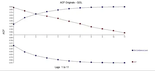

I am trying to estimate a model for my time series data. The data contains Quality Of Life Index values from 1975-2006.
auto.arima() suggests an ARIMA(0,1,1) model but I am still confused as to how to interpret it from the ACF and PACF plots of the first differences time series.

It is always useful to know the assumptions underlying any "automatic procedure" . The software you are using (and nearly all others) assume among other things
1) that there are no pulses in the data set .... you have 3
2) there are no level shifts (intercept changes) in the data set
3) there are no seasonal pulses in the data set
4) there is no deterministic time trend variables in the data set
AND
5) that the data has an error process w constant error variance .. yours changed at period 14
6) that the parameters of the model are invariant over time
Unfortunately for you items 1 and 5 have been tested for and found evident in your data suggesting model structure i.e. mitigation.
To begin with your 32 annual data is plotted here (visually supportive of the conclusions regarding item # 5 ) enter image description here or possibly item #6.
The approach is to use as you did the original acf enter image description here and the pacf here enter image description here
AS @Adamo (Interrupted Time Series Analysis - ARIMAX for High Frequency Biological Data? ) wisely pointed out in his reflections "The correlogram should be calculated from residuals using a model that controls for intervention administration, otherwise the intervention effects are taken to be Gaussian noise, underestimating the actual auto-regressive effect." in other words violations of assumptions 1-6 can muddle the standard arima model identification schemes which is the source of your quandary and befuddlement.

In conclusion the acf/pacf enter image description here of the model errors suggests sufficiency as there is no evidence of autoregressive structure
