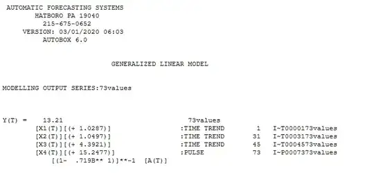

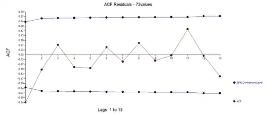

After adjusting for these 6 deterministic series , this is what the acf/pacf looks like enter image description here suggesting an ar(1) model (1,0,0) . The final equation is here enter image description here and here enter image description here with the acf of the residuals here enter image description here

I looked closely at the errors from the above model and found that there was a significant increase in error variance (now visually obvious) which yielded this test result.
The model is now simpler with only 1 pulse enter image description here and the Actual/Fit and Forecast here enter image description here showing 95% prediction limits using Monte-Carlo simulation procedures.
with a "much leaner" acf of the model residuals here enter image description here
