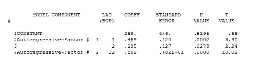

Initially the acf of the original series is here enter image description here clearly suggesting strong seasonal auto-regressive structure akin to the classic airline series of Box and Jenkins. The suggested model is (2,0,0)(1,0,0) a quite simple model in thew span of possibilities. I can't imagine why even band-limited procedures wouldn't deliver a similar model because the identified anomalies are VERY small BUT highly significant.
The Iterative modelling process https://autobox.com/pdfs/ARIMA%20FLOW%20CHART.pdf evolved to the following potentially useful model .
enter image description here and here in more detail enter image description here withenter image description heremodel statistics here enter image description here

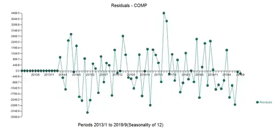

The model residuals are here enter image description here with an ACF here enter image description here

STEP 1 : examine possible models following two mutually exclusive and distinctive paths ... Path 1 .. investigate possible arima models using a superset of the aic/bic ... auto.arima approach and for each possible prospect identify and incorporate additional deterministic structure that is statistically significant THEN take Path2 which identified deterministic structure and then incorporates/adds any evidented arima structure..... Select the most promising path penalizing models for excessive parameters
Note that models of the form enter image description here are also considered as a wide search is made for an equation that is as good as the human eye or at least similar as possible.
In this case the best model had an a seasonal ar(12) and a 2 parameter ar polynomial
