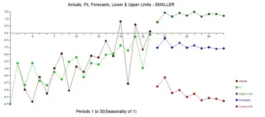

This time I unleashed the monte-carlo bootstrapping option (2000 realizations per forecast period) where the residuals get re-sampled and limits are then based upon them. Furthermore I optionally enabled pulses to be present in the simulations thus 33.33% ( 4 out of 12 ) where you had correctly guessed 1 of 4 ) had pulses in the realizations because 4 pulses were found in the 12 (18-12) non-zero residuals.. 20 observations minus 2 for the ar and minus 6 for the estimated parameters enter image description here .In this way a more realistic assumption i.e. the possible re-occurrence of pulses in the future are put in place.
In this manner probability density functions can be constructed based upon the actual distribution of residuals without having to give that distribution a name.
enter image description here and the forecasts here enter image description here
Prof. Sam Savage https://www.probabilitymanagement.org/ was inspirational in motivating this particular developmemt of AUTOBOX to meet his simulation/analytical requirements as he wished to have realistic forecasting limits.
A table comparing standard normality-assuming limits(right-hand side of table ) versus the monte-carlo/simulation approach (left) is illuminating. enter image description here
