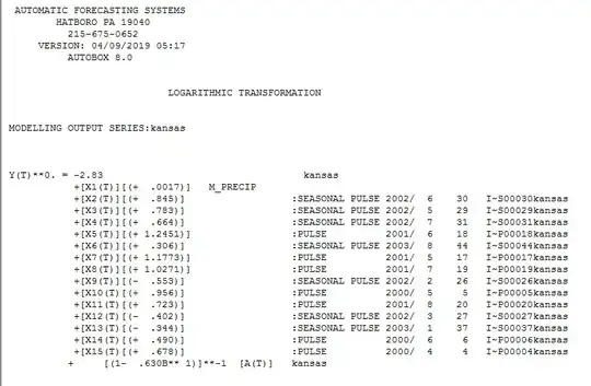

EDITED AFTER RECEIPT OF DATA:
I took your 192 values and partitioned then to 156 and 36 and obtained a Weighted Mape of 21.2% . enter image description here and enter image description here
The model included a log xform and an arima of (1,0,0) along with 7 seasonal pulses refelecting a monthly determiistic structure while incorporating your predictor variable contemporaneously and adjusting for 7 anomalies (pulses).
The residuals from this model suggested randomness enter image description here.
The Actual/Fit and Forecast graph is here
Finally a derailed loo at the 36 period forecasts vis-s-vis the actual is here
