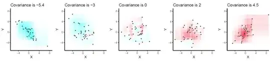

Sometimes we can "augment knowledge" with an unusual or different approach. I would like this reply to be accessible to kindergartners and also have some fun, so everybody get out your crayons!
Given paired $(x,y)$ data, draw their scatterplot. (The younger students may need a teacher to produce this for them. :-) Each pair of points $(x_i,y_i)$, $(x_j,y_j)$ in that plot determines a rectangle: it's the smallest rectangle, whose sides are parallel to the axes, containing those points. Thus the points are either at the upper right and lower left corners (a "positive" relationship) or they are at the upper left and lower right corners (a "negative" relationship).
Draw all possible such rectangles. Color them transparently, making the positive rectangles red (say) and the negative rectangles "anti-red" (blue). In this fashion, wherever rectangles overlap, their colors are either enhanced when they are the same (blue and blue or red and red) or cancel out when they are different.
Positive and negative rectangles
(In this illustration of a positive (red) and negative (blue) rectangle, the overlap ought to be white; unfortunately, this software does not have a true "anti-red" color. The overlap is gray, so it will darken the plot, but on the whole the net amount of red is correct.)
Now we're ready for the explanation of covariance.
The covariance is the net amount of red in the plot (treating blue as negative values).
Here are some examples with 32 binormal points drawn from distributions with the given covariances, ordered from most negative (bluest) to most positive (reddest).
Covariance plots, updated 2019
They are drawn on common axes to make them comparable. The rectangles are lightly outlined to help you see them. This is an updated (2019) version of the original: it uses software that properly cancels the red and cyan colors in overlapping rectangles.
Let's deduce some properties of covariance. Understanding of these properties will be accessible to anyone who has actually drawn a few of the rectangles. :-)
  • Bilinearity. Because the amount of red depends on the size of the plot, covariance is directly proportional to the scale on the x-axis and to the scale on the y-axis.
  • Correlation. Covariance increases as the points approximate an upward sloping line and decreases as the points approximate a downward sloping line. This is because in the former case most of the rectangles are positive and in the latter case, most are negative.
  • Relationship to linear associations. Because non-linear associations can create mixtures of positive and negative rectangles, they lead to unpredictable (and not very useful) covariances. Linear associations can be fully interpreted by means of the preceding two characterizations.
  • Sensitivity to outliers. A geometric outlier (one point standing away from the mass) will create many large rectangles in association with all the other points. It alone can create a net positive or negative amount of red in the overall picture.
Incidentally, this definition of covariance differs from the usual one only by a constant of proportionality. The mathematically inclined will have no trouble performing the algebraic demonstration that the formula given here is always twice the usual covariance. For a full explanation, see the follow-up thread at https://stats.stackexchange.com/a/222091/919.

    Now if only all introductory statistical concepts could be presented to students in this lucid manner … – MannyG Nov 10 '11 at 18:26
    @whuber: You should stop editing posts and start posting answers ;) Simply stunning! – PhD Nov 11 '11 at 00:10
    This is beautiful. And very very clear. – mako Jun 02 '12 at 15:37
    I will do something similar if/when I next teach an introductory statistics class. I wish somebody had done so for me when I was first learning statistics! – mako Jun 02 '12 at 15:47
    Having done the algebra, I wonder if "universal constant of proportionality (independent of the data set size)" may be misleading, so I want to check if I understood the procedure correctly. For {(0,0),(1,1),(2,2)} there are $3\choose{2}$ = 3 possible rectangles of areas 1, 1 and 4. They're all red so the "covariance" is 6. And {(0,0),(1,1),(1,1),(2,2)} has $4\choose{2}$ = 6 rectangles, all red or zero, of areas 0, 1, 1, 1, 1 and 4 so "covariance" is 8. Is this right? If so it's $\sum_{i<j}(x_i-x_j)(y_i-y_j)$. – Silverfish Nov 07 '13 at 10:42
    @Silverfish Yes, I should have indicated that the constant was universal after averaging the values rather than summing them. – whuber Nov 07 '13 at 17:23
    Thanks, this as I suspected. I realised that an extra factor of 2 comes out if the sum is taken over all $i, j$ rather than $i<j$. I think the only other ambiguity is whether the "pair" $(i,i)$ counts - the area of the rectangle is zero, but if averaging rather than summating it clearly makes a difference! Incidentally when I teach covariance I also use the "positive and negative rectangles" approach, but pairing each data points with the mean point. I find this makes some of the standard formulae more accessible, but on the whole I prefer your method. – Silverfish Nov 08 '13 at 17:00

  • If a rectangle has long sides and a high width or short sides and a short width, it provides evidence that the two variables move together.
  • If a rectangle has two sides that are relatively long for that variables, and two sides that are relatively short for the other variable, this observation provides evidence the variables do not move together very well.
  • If the rectangle is in the 2nd or 4th quadrant, then when one variable is greater than the mean, the other is less than the mean. An increase in one variable is associated with a decrease in the other.
I found a cool visualization of this at http://sciguides.com/guides/covariance/, It explains what covariance is if you just know the mean. link via the wayback machine

Here's another attempt to explain covariance with a picture. Every panel in the picture below contains 50 points simulated from a bivariate distribution with correlation between x & y of 0.8 and variances as shown in the row and column labels. The covariance is shown in the lower-right corner of each panel.
Different covariances, all with correlation = 0.8
