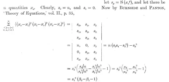

$$\left| \mathbb A \right| = \sum_{n \ge k \gt j \gt i \ge 1} \left[(x_k-x_j)(x_k-x_i)(x_j-x_i)\right]^2.\tag{*}$$

$$\mathbb X \mathbb X^\prime = \pmatrix{S_0 & S_1 & S_2 \\ S_1 & S_2 & S_3 \\ S_2 & S_3 & S_4}.$$
This simplifies, because $(*)$ shows it is a function only of the differences among the data, quantities that do not change when a constant is added to all the data values. Add the negative of their mean to each term (that is, center the data) to make $S_1=0.$ Obviously $S_0=n,$ giving
$$ 0 \le \left|\matrix{n & 0 & S_2 \\ 0 & S_2 & S_3 \\ S_2 & S_3 & S_4}\right| = n\left|\matrix{S_2 & S_3 \\ S_3 & S_4}\right| - S_2\left|\matrix{0 & S_2 \\ S_2 & S_3}\right| = n(S_2S_4 - S_3^2) - S_2^3.$$
The kurtosis $\kappa = (S_4/n)/(S_2/n)^2$ and skewness $\beta = (S_3/n)/(S_2/n)^{3/2}$ are defined only when the variance is nonzero, which implies $S_2$ is nonzero. We may therefore divide both sides of this inequality by the positive quantity $n^3S_2^3$ to give
$$0 \le \frac{n(S_2S_4 - S_3^2) - S_2^3}{n^3 S_2^3} = \kappa - \beta^2 - 1$$
to conclude
$$\kappa \ge \beta^2 + 1.$$

Consider the quadratic form
\begin{align} Q(a, ~b,~c) & := \frac1n\sum \left(a + xb+ x^2 c\right)^2 \\ &= a^2\cdot v_0 + b^2\cdot v_2 + c^2\cdot v_4+ 2ab\cdot v_1+ 2bc\cdot v_3+ 2ca\cdot v_2,\tag 1\label 1\end{align}
that is, $v_i:= \frac{\sum x^i}n,~i\in \{0,~1,~2,~3,~4\}.$
$\eqref{1}$ is positive semi-definite.
Then the determinant of the matrix of the quadratic form $\eqref{1}$
$$\begin{vmatrix}v_0 & v_1 & v_2\\ v_1 & v_2 & v_3\\ v_2 & v_3 & v_4\end{vmatrix},\tag 2\label 2$$ would be non-negative.
Now, take $v_1 = 0,~ v_2 = 1.$ Then $\eqref{2}$ reduces to
$$\begin{vmatrix}1 & 0& 1\\ 0 & 1& \gamma_3\\ 1 & \gamma_3 & \gamma_4\end{vmatrix}\geq 0.\tag 3\label 3$$
The rest follows by expanding $\eqref{3}.$

$\rm [I]$ A Note on Skewness and Kurtosis, J. Ernest Wilkins, Jr., Ann. Math. Stat. $15 ~(1944),$ p. $334.$
