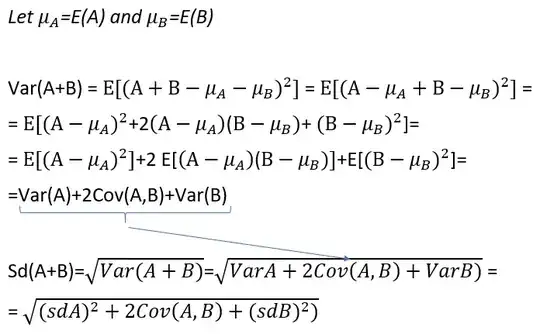

The first thing to notice is that Var(A+B) equals VarA + Var B only when Cov(A,B)=0.
To gain some intuition behind the relationship between sd(A+B) and sd(A)+sd(B), notice that in order to complete the square in this expression enter image description here
Cov(A,B) would have to equal sd(A)*sd(B). The next question is whether that ever happens? Indeed it does. The Cauchy Schwartz inequality gives us the inequality below:
enter image description here.
Whenever the following equality holds enter image description here, we can complete the square and obtain that sd(A+B)=sd(A)+sd(B). However, in all other cases, sd(A+B) will not equal sd(A)+sd(B).
