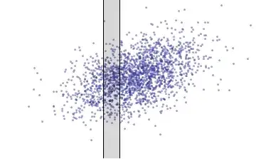

To discuss the concepts, I am going to make an "ink = probability" metaphor by considering scatterplots of large independent samples of $(x,y)$. If $A$ is any (measurable) region within the scatterplot, then the proportion of ink covering $A$ closely approximates the probability of $A$ under the joint distribution of $(x,y)$.
Figure 1
$x$ is plotted on the horizontal axis and $y$ on the vertical. $A$ is the rectangle. The proportion of blue ink drawn on this rectangle equals the proportion of the 2000 dots used, which reflect the joint probability density of $(x,y)$.
The statistical definition of independence of two random variables $x$ and $y$ is that their joint distribution is the product of the marginal distributions. The marginal distribution of $x$ is obtained by taking thin vertical slices of the scatterplot: the chance that $x$ lies between $x'$ and $x'+dx$ equals the proportion of ink used for all points in this region, regardless of the value of $y$: that's a vertical strip.
Figure 2
Now, in any vertical strip, some of the ink appears more in some places than in others. Compare these two strips:
Figure 4
In the right-hand strip in this illustration, the blue ink tends to be higher (have larger $y$ values) than in the left-hand strip. This is lack of independence. Independence means that no matter where the strip is located, you see the same vertical distribution of ink, as here:
