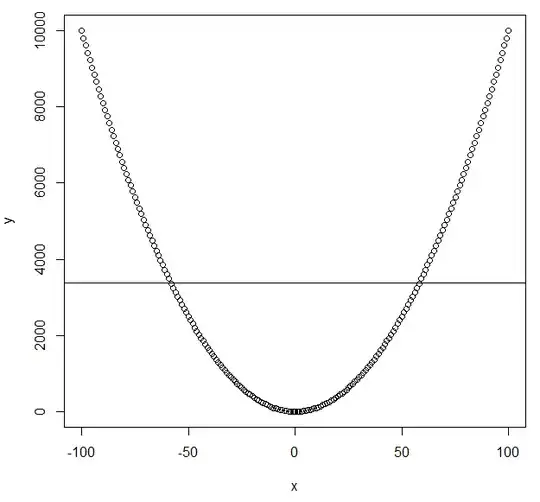

Note that had you chosen a discrete uniform on e.g. $-100, -99, \dots, 99, 100$ and rescaled that to being between $[-1,1]$ and you would have found a covariance and correlation of zero, as happens in the linked Math SE thread. There is neither an increasing nor decreasing relationship.
x=-100:100; y=x^2
plot(x,y)
abline(lm(y~x))
scatter plot of uniform x with negative and positive values, and its square
As an exercise to think through, what would be the correlation between $-1, -2, -3, \dots, -n$ and its squares? You can easily write some R code to confirm your guess.
If all you care about is the existence of an increasing or decreasing relationship, rather than the extent to which it is linear, you can use a rank-based measure such as Kendall's tau or Spearman's rho, as mentioned in Glen_b's answer. For my first graph, which had a perfectly monotonic increasing relationship, both methods would have given the highest possible correlation (one). For the second graph, which is neither increasing nor decreasing, both would give a correlation of zero.
