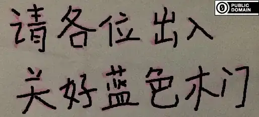

This is on a door where I'm staying.
If we put it directly into Online OCR, it says:
No recognized text !
The image quality is too poor.
Step 1: Improve the image quality.

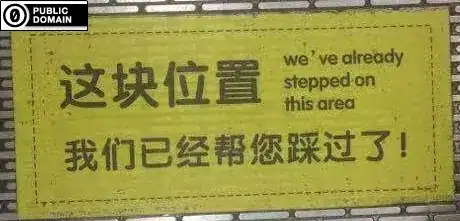

Let's begin with a real example: a funny photo I took in Tianjin:
So... what does this say?
Step 1: Use Chinese OCR to get the plaintext Chinese.
The best software for doing this changes over time. I Googled Chinese OCR and stumbled upon Online OCR. Another possibility is the Copyfish OCR browser extension (Chrome; Firefox). I understand both Hanping Chinese and Pleco are mobile options.
After uploading the image and selecting Chinese Simplified, we get:
这块位置we've alreadyetepped enthis area 我们已经帮您踩过了!
Step 2: Input the plaintext Chinese into translation software.
For example, Google Translate gives:
这块位置
This location
我们已经帮您踩过了!
We've helped you step over!
For the words that seem imprecisely translated, we can look them up in a dictionary, e.g. YouDao or Dict.cn, or even just copy/paste the whole thing into Yabla.
Step 3: Still don't know? Ask on Chinese.SE showing what you've done.
Which is what I did for this image: What does 我们已经帮您踩过了 mean in this peculiarly translated escalator sticker?

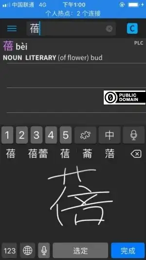

Drawing on your phone
If your phone has Chinese input installed, you likely can already do this. E.g., here I'm entering in my name into Pleco:

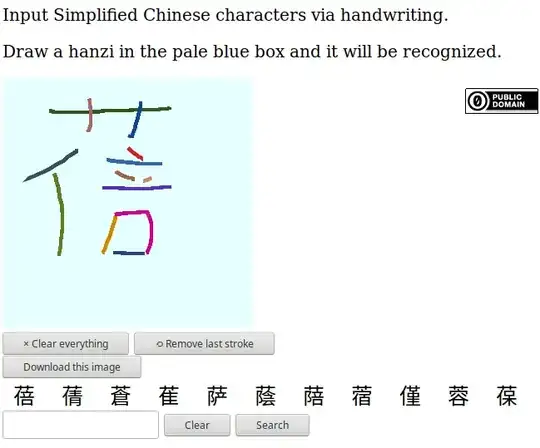

MDBG Online Dictionary
MDBG will accept hand drawn characters, but it does care about stroke order. Click on the "brush" icon next to the search box:
mdbg.net stroke input

Google Translate
It's possible to draw characters using Google Translate by clicking the pencil icon:
hand-drawn 你 inputted into Google Translate
