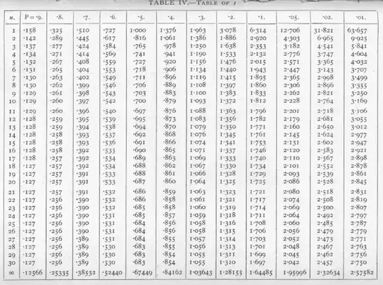

I did some investigation on this issue, and the earliest source I can find is Fisher's Statistical Methods for Research Workers (1925). I remember examining a copy of this text (you can see http://psychclassics.yorku.ca/Fisher/Methods/, for example) and noticing that the following table neatly fit on one page.
From what I recall reading in the text, there is nothing justifying why Fisher chose to stop at $n = 30$. So as far as I know, the only justification for this is that such tables can fit neatly on one page back in the day.
