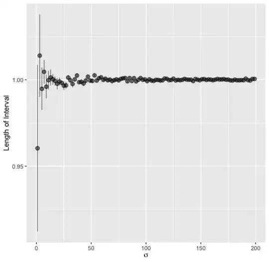

Here is a little plot of a simulation I performed. I construct 10 confidence intervals for varying levels of $\sigma$ and compute their lengths. I use the exact calculation ($n = (2 \cdot 1.96)^2 \sigma^2$ rather than the rule of thumb, which will result in smaller confidence intervals since $16>(2 \cdot 1.96)^2$). When the noise is small, our computation results in fewer samples, meaning the difference between using a z and t stat becomes important. As more noise is added, that difference becomes negligible.
