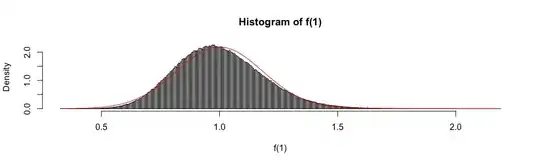

The short answer is that it can go pretty badly, but only if one or both tails of the sampling distribution is really fat.
This R code generate a million sets of 30 gamma-distributed variables and take their mean; it can be used to get a sense of what the sampling distribution of the mean looks like. If the normal approximation works as intended, the results should be approximately normal with mean 1 and variance 1/(30 * shape).
f = function(shape){replicate(1E6, mean(rgamma(30, shape, shape)))}
When shape is 1.0, the gamma distribution becomes an exponential distribution, which is pretty non-normal. Nevertheless, the non-Gaussian parts mostly average out and so Gaussian approximation isn't so bad:
histogram & density plot
There's clearly some bias, and it would be good to avoid that when possible. But honestly, that level of bias probably won't be the biggest problem facing a typical study.
